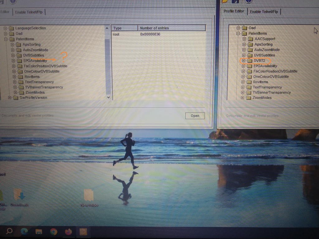

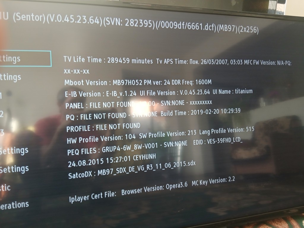

Teşekkür ederim efendim, bu DVB_T2 ile ilgili sorunu çözmedi, başka seçenekler var mı?
1. On the original board (17MB97) DOES DVB-T2 WORK?
2. In my country, DVB-T2 is not used, so I was not interested. And neither is DVB-S.
3. Save the TV profile to the stick and see what you find. SWProfile = PatentItems = DVBT2 = DVBT2 = TRUE
You can also post a picture of MENU 4725.

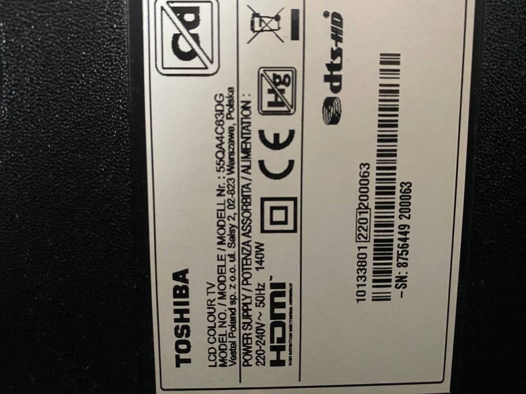

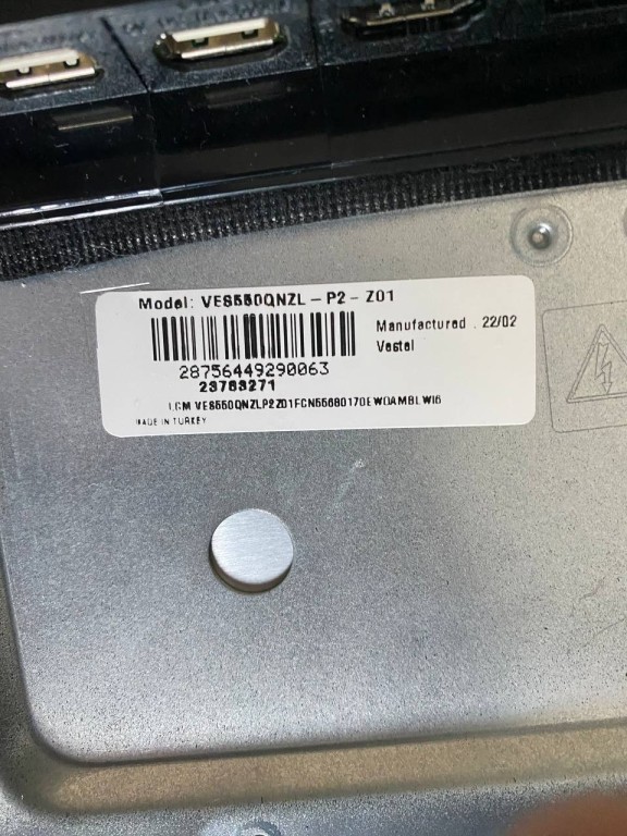

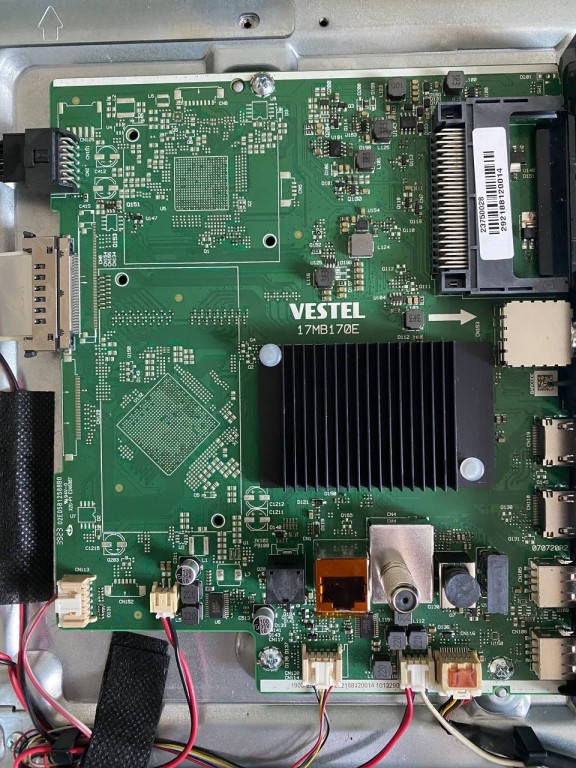

Hello, guys! Sorry, I don't speak your language. 🙁
Someone replaced the mainboard in this TV. It was working well, but when I launched the built-in YouTube app, stripes would appear, the TV would freeze and then reboot. I flashed the first firmware I could find with a similar panel — from a Daewoo 55DM54UA (17MB170, VES550QNDH-N2). Now the image is doubled and stretched. Please help me with the correct file if possible! 😊 +It doesn't enter the service menu (menu4725)

In the profile saved from the TV, there is NO DVB-T2 function. I don't know what software was rewritten. I have a profile saved from 17MB97 with this function active. You can copy swprofile to the TV. At your own risk.
Unzip. Folder on stick. USB Operations/ ok. Turn off the TV and turn it on when the STBY LED stops blinking.
I don't have anything in the archive that can help you.

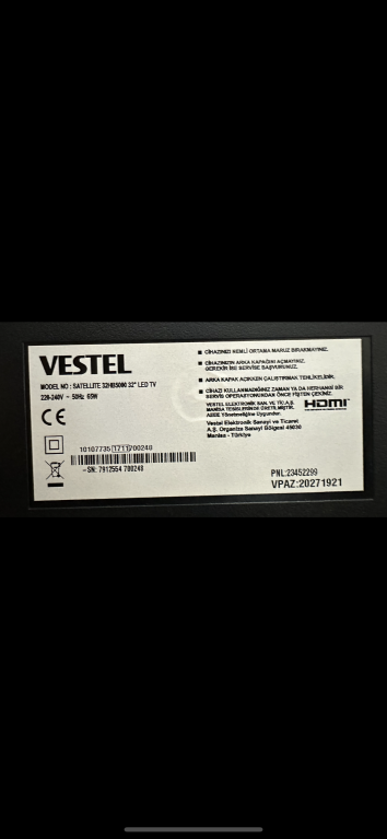

Selam. Vestel 32HB5000 televizyonum açılmıyor kendi kendine reset atıyor. Kurtarma yazılımı talep edebilir miyim

Ok, thank you!
Another update — I found an old mainboard! With it, the TV does boot up, but the buttons almost don’t respond, I can’t access the menu or the service menu, and it behaves poorly. It constantly shows the message: “Memory full.”
If you remember, for Chinese mainboards there used to be a small file — around 17KB — that would force the TV into recovery mode and perform a hard reset.
Is there something similar available for our platform? Thanks! :)
