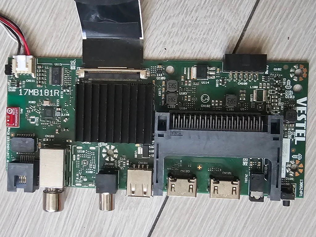

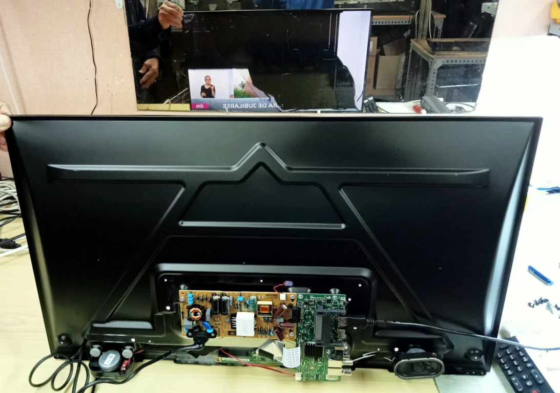

We have a major redesign in vestel HD/FHD platform. Mew chassis (with a single central LED strip and different speakers), new power board (IPS65) and new mainboard design (MBxxxR, with built-in wifi and IR but no AV input). Some photos:
16,917
