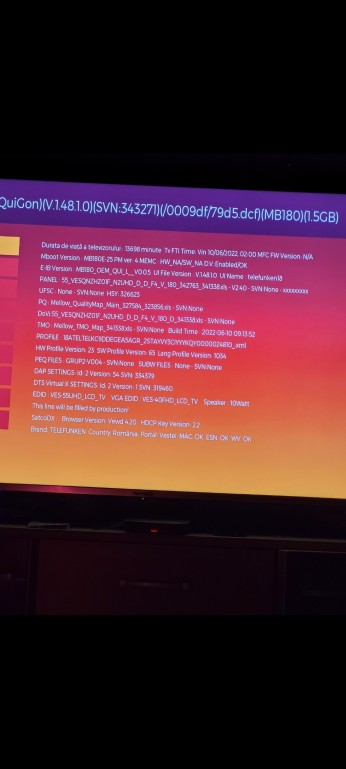

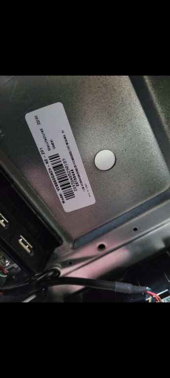

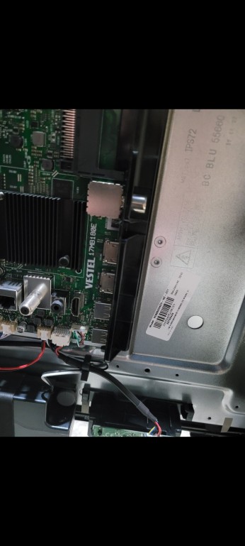

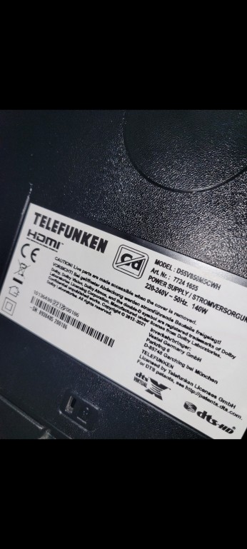

Good evening, I have a Telefunken television with a software issue. I posted about it on the site a year ago, and my wife helped me with a software update for Vestel. The television works, but it boots very slowly during a power outage, or the Netflix APK no longer works and requires a software reinstall. I'll share some pictures of the television model, motherboard, and panel. My question is: Has the software for this television been released?

Hello, the software we share in this forum is for TVs manufactured in Turkey. It's not fully compatible with TVs manufactured abroad, so yokoono is helping with these. I've tagged yokoono. He'll see the thread and help you when he logs into the forum.

Ihave this:
Full software17MB180E panel VES550QNZH-N2-Z01 - (G31). Unfortunately I didn't write what model of TV it is.
Update software 17MB180E QuiTelefunken V.1.64.1.0 - (G32)
For G31 last software is v 1.48.1.0
For G32 last software is v 1.64.1.0
