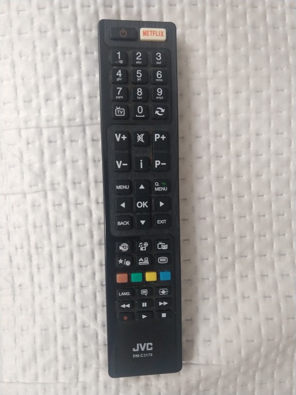

Hello dear colleagues. I apologize if I posted in the wrong place. I need help.
On a Telefunken TV with main 17MB211S another software was rewritten and the remote control code was changed.
The menu became inaccessible and I can't move on. I couldn't find the remote control.
Does anyone know what brand of TV this menu is from?

Hello yokoono yokoono master, Which is the new software you installed ?
V0 ?
V1 ?
V3 ?
If you know, you can try a different full version. When changing the remote control, the OK button on the remote control works to load different software.

yokoono Çevrimdışı
2,978
1. I don't know what version of the software was rewritten
2. The remote control doesn't have the OK key or any other keys enabled
3. I've tried several remote controls (Telefunken, JVC, Toshiba, Panasonic, etc.) even programmable ones. No result.

If you have another mb211 Full software in your archive, try it. OK button does its job while installing the software.
yokoono Çevrimdışı
2,978
I'll rewrite the flash memory with a dump from Telefunken and see what happens.
I thought a colleague could tell me which TV the picture with that menu is from.
